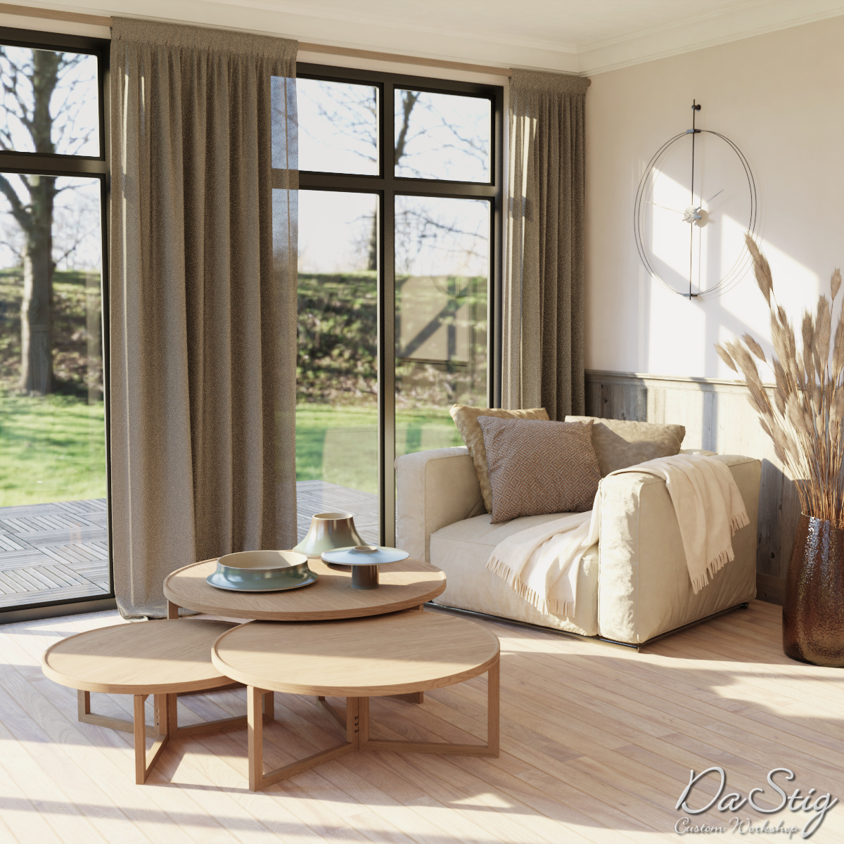

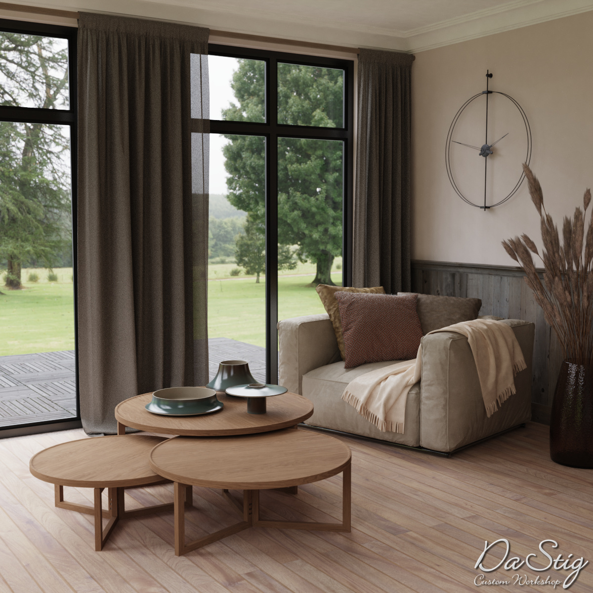

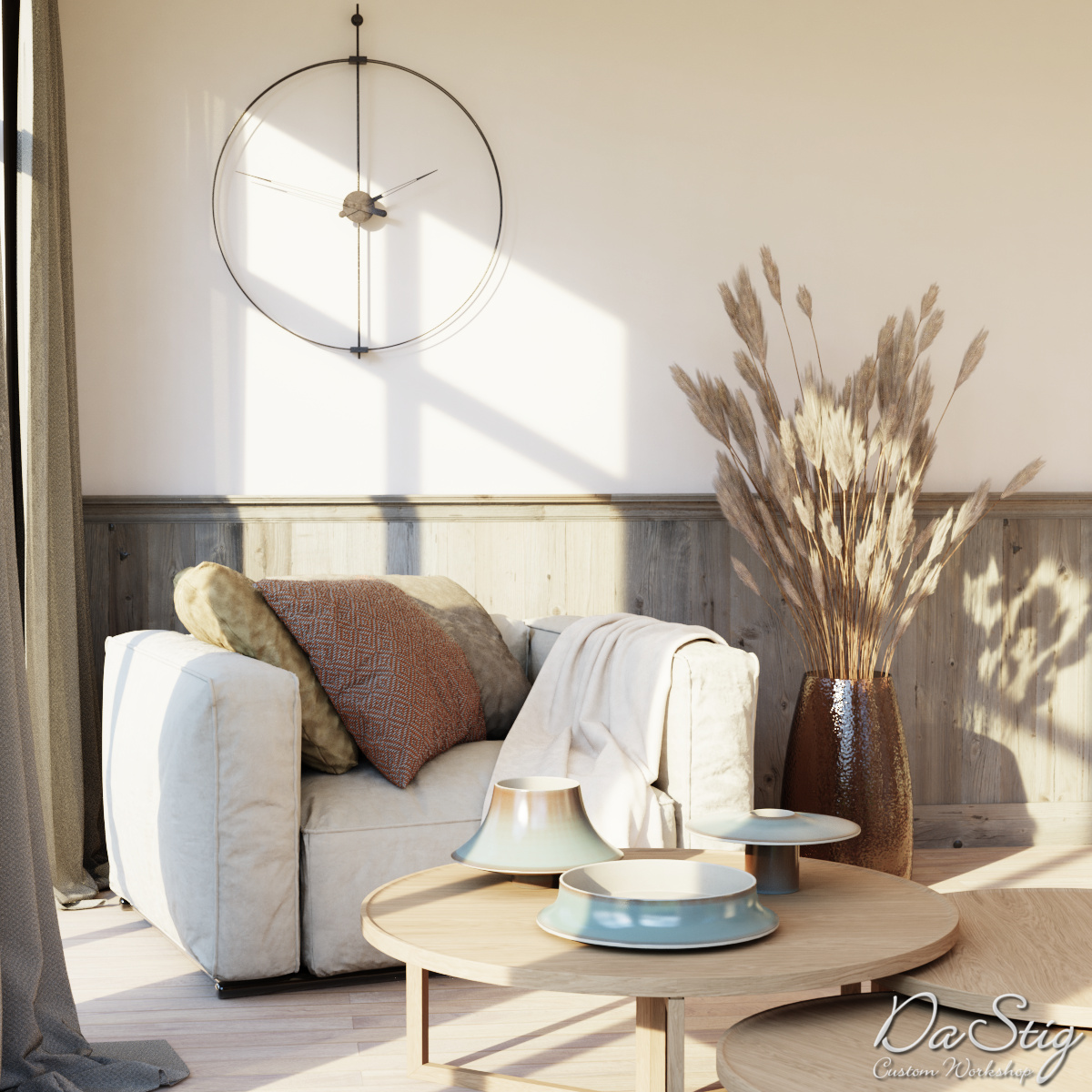

Recently did an interior rendering. Looks pretty neat I guess.
Open for remarks and points to improve.

  • Lighting: just a single HDRI is used, no extra pins or arealights (from polyhaven.com). The first render uses a rather overcasted HDRI, for the 2 other renders, I used an HDRI with some sun in it to get those strong shadows.

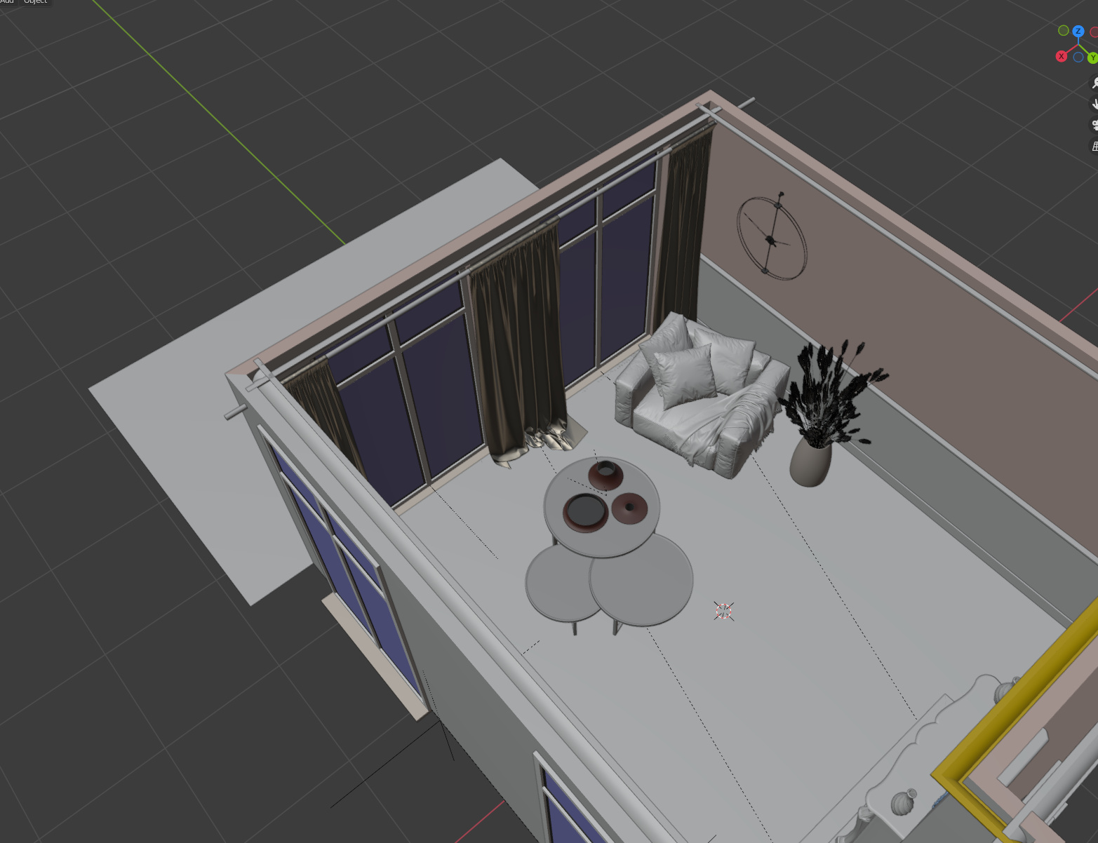

Here is what the model looks like in Blender. As you can see, on the outside, only the terrace is 3D, so the outsde grass is HDRI.

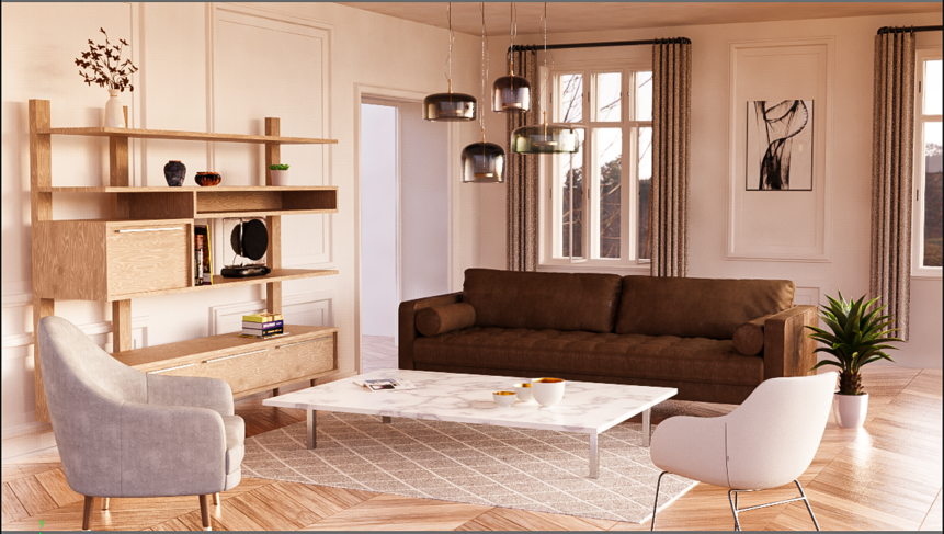

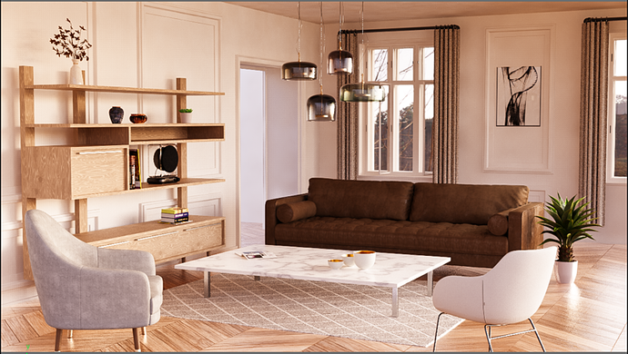

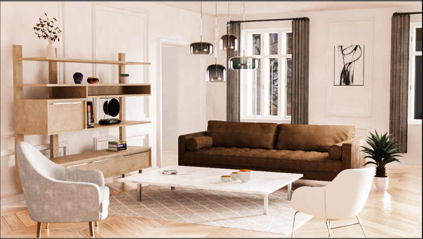

As you can see in my attached pictures, I hardly reach photorealism…maybe not enough samples, maybe not enough GI or shadow quality…or maybe the materials are just not refined enough.
If you have any idea, I’d gladly read feedback! :slight_smile:
@da.stig nice! Lighting works really well! In your last render it’s more obvious the grass is from the HDR because there’s quite a difference in the sharpness of the grass compared to the terrace but that’s something which is easy to fix.
@philipp.baumgartner the second one is not bad at all I think, the top one really lacks shadows in for example the cabinet on the left. I always wonder what it makes that we experience something as real or not. And most of the time I think it’s things being too perfect lit or too clean.
Like on a really nice day it might be possible a room is indeed lit like your room but it would need a totally glass wall on the right side. Still, the shadows are quite soft so it’s not corresponding with being lit by the sun (more with diffuse lightbox kind of things) which should basically be really low already to get into the room that far.
I think if you would drop a plane on the right to cover off a lot of the light your render would lose a lot of the perfectly lit feel and therefor might get more realistic.

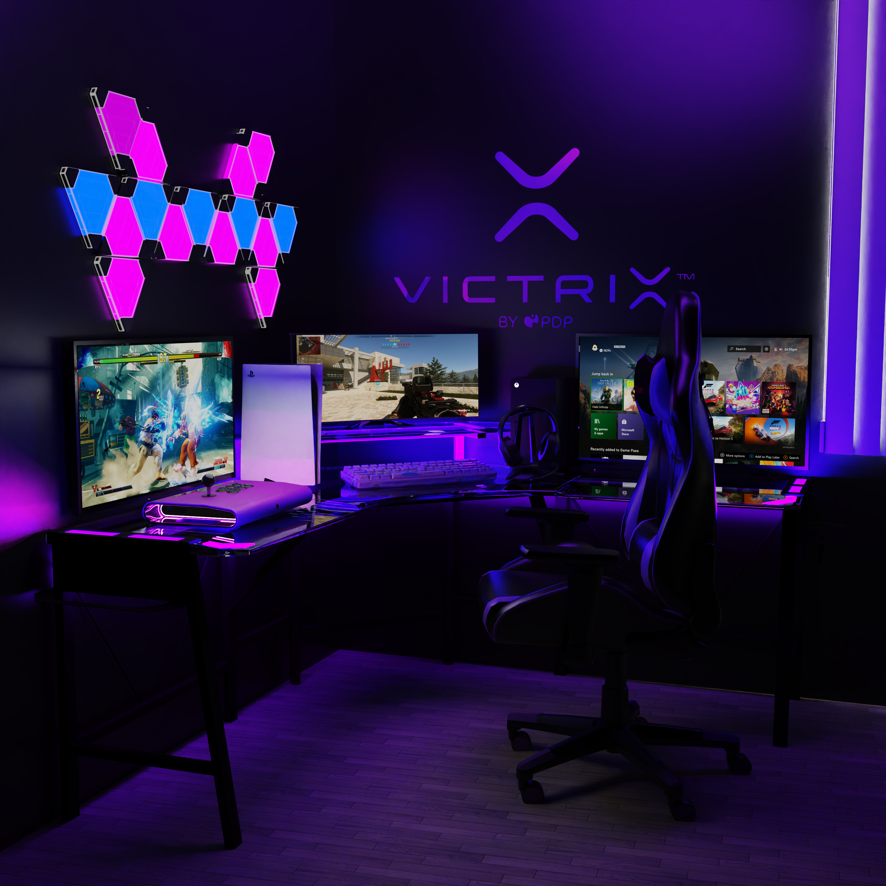

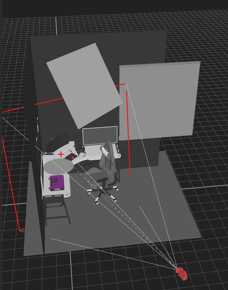

I’ve also had some great luck with creating interiors with Keyshot.
One of the projects I’ve been working on is creating a branded gamer room for marketing and social purposes so we can drop in our products into the scene and use portions of it so the products are in environments that are believable.
Only issue is that with so many lights and assets, the file starts to get pretty heavy and really takes a toll on program and operation speed.

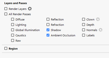

Great renders! i actually love the first shot. But in my experience creating interior renders with keyshot, Image style or post pro does really matters, a lot. for example, you can setup the image style in keyshot like exposure, colour balance, tone mapping etc (you can also use PS as a post pro workflow after render), it actually can make a big difference from the same lighting setup, you have to “train” your eye to get it right, i suggest you can get some real photo refferences when youre rendering to know which aspect in your render that you already done right or need to refine more.
if you need more ambient occlusion or more shadow, you can use render pass and use it photoshop to enhanced the shadow even more without changing the lighting setup
Dear Ayyas,
thanks for your feedback and suggest of using render passes. I never used them before, because usually I am quite happy with my results after the postproduction in Lightroom. But I guess when it comes to interior renders, that’s something to be considered differently.
Thanks for the help! :wink:
